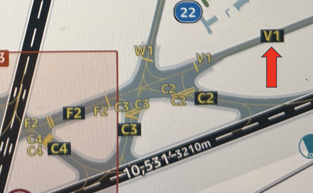

AvHerald oggi riporta: "On Feb 13th 2026 the Belgian Air Accident Investigation Unit (AAIU) reported that after being cleared for takeoff from runway 07R the aircraft mistakenly lined up taxiway E1 at the intersection of taxiways Outer 10/C6, C5 and E1/Z and began a rolling takeoff. At the 100 KIAS call out the crew became aware of the misalignment. The aircraft reached 126 KIAS before brakes were applied and the thrust reversers deployed. The aircraft came to stop on the paved surface adjacent to the taxiway edges near the intersection of taxiways V1 and C1. There were no injuries, the aircraft did not sustain any damage. The occurrence was rated an incident and is being investigated by the Belgian AAIU".
